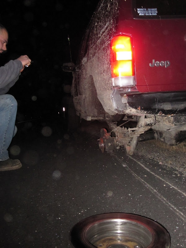

Just for the record:
Whenever I drive my XJ to a wheeling destination, at the end of the day I check over EVERYTHING. When I got into this sport I was driving home one day and felt like my tires were loose. Sure enough, my lug nuts had come loose. A wheeling veteran, who is also a friend of mine, told me that I should always check my rig top to bottom, front to back, and check ALL lug nuts prior to my driving home. The forces of wheeling can cause things to come loose.
BEFORE I drove this Sunday I did exactly that - something that I've been doing since the day I was told to do it - whenever I drive my rig home from the trail. All the lug nuts were nice and tight, all the suspension and steering componets were nice and snug, the XJ was ready for an uneventful drive home.
Here's a pic for you guys, better explanation to come in the next few days once I get re-settled from having been away for a week.
Nothing like changing an axle shaft on the side of a road before you even hit the interstate. The mounting holes on the rims actually wallowed out and chewed up the lug nuts, unit bearing, and unit bearing bolts
Then after 45 miles of driving on the interstate the rear wheel decides to sheer the lug nuts clear off the axle shaft flange and leave me to get to the side of the road on only 3 tires. Turns out these holes had wallowed out too causing the rim to fail and this crap to happen:
Now my hypothesis on this is: When I checked all the lug nuts and their tight-ness, it's possible that I was just tightening the lug nut further into the already wallowed out holes giving me the impression that I was getting them nice and tight. You don't feel loose lug nuts (at least in my experience) at low speeds.
