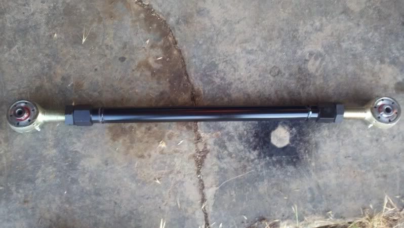

I got tired of trashing my track bar regularly, so I decided to make some alterations. I got some joints and tubing from Parts Mike and built this track bar.
I modified my heavy duty lower mount I made to accept the new joints, which are larger than Johnny Joints. Didn't take much, moved one flange and drilled the hole to 9/16" for the larger bolt. But when I hooked the bottom in and went to make the top bracket, I noticed I was going to get some interference with the axle components and the sway bar mount. The reason for this is that I have a high steer and had to move the mount up 5" and toward the driver side, which made a shortened track bar in the first place. So, I decided to move the tie rod end on the steering box side up 4". To do this, I used a pitman arm off a Camaro
You will notice it is almost 2" longer, which is a good deal since the upper arm on the high steer is also longer. This will compensate for that nicely. Here is a pic installed.
This will also place less strain on the steering box when wheeling.
Here is the mount I made. It is a little higher than the stock mount and is about even with the bump stop.
Here is the finished product. Drag link and track bar exactly the same length and parallel.

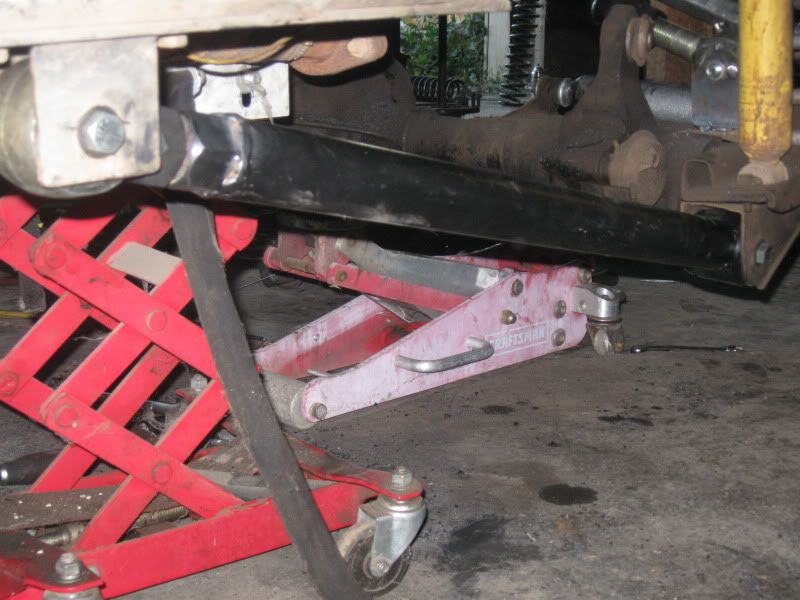

Finished my new really heavy duty three link suspension today. It uses 3" rod ends and bushings from Parts Mike, DOM tubing and 1/4" steel brackets welded to the frame. I had a Y link, but I made it as a temporary suspension to play with until I decided what I would end up with. Here is the results.

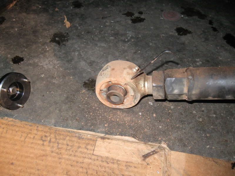

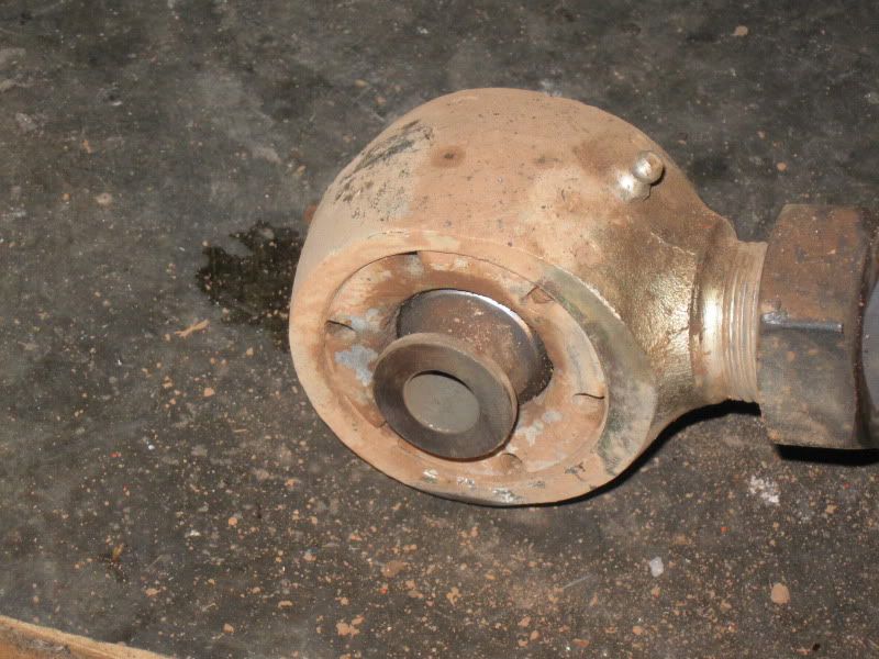

Now comes the part on why I chose the joints that I did. They are not the cheapest, but I thought they were the best because of ease of rebuilding and adjusting. One of my spherical rod ends had become dry from being in mud and water while wheeling. It was beginning to rattle slightly when hitting stuff. So, it was time to grease and adjust it. The first thing was to take it loose. You can see it looks dry.
Second, remove a small allen screw that keeps the halves from unscrewing.

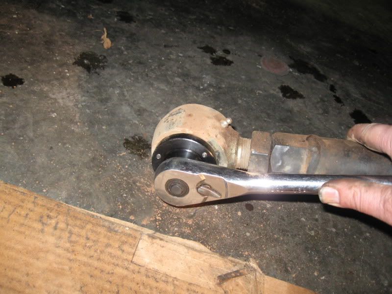

Parts Mike has a special spanner that fits a half inch drive ratchet that they threw in for no extra charge when I bought my joints. A plethora of bovine manure never hurts.
Fit the spanner in the holes on the side and then turn the ratchet clockwise, without having to remove the arm or use any presses or snap ring pliers.
Insert the allen screw, grease and bolt it back up. A little extra cash paid off in time and lack of frustration.
