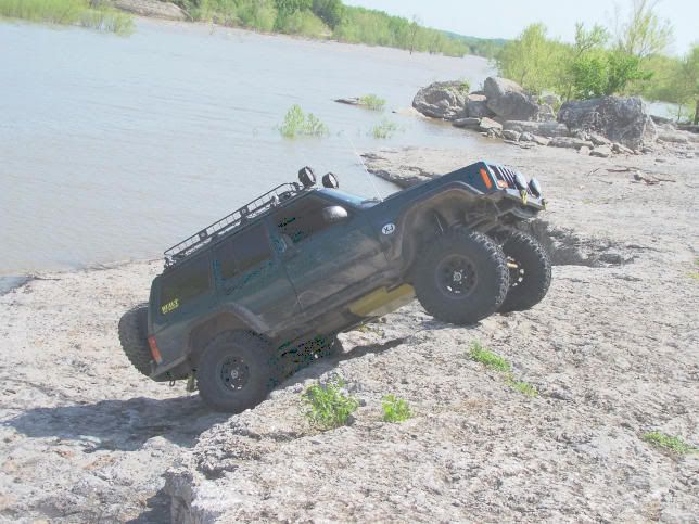

Ok, so not quite as stock as others on here.
The specs-
Engine Specifications:
4.0 H.O. w/160 K + miles
Engine Misc.:
60 mm Throttle Body Spacer
FlowMonster Highflow Cat
Flowmaster 40
Electric Fan On Switch
Brown Dog Polly Motor Mounts
Rusty's Air Tube (customized) and K&N 6x9 Cone
Hood Spacers
Drive Train:
AW4
231 T-case
Novak Shifter
HP Dana 30 4.88 Yukons & Lockrite. Ruff Stuff Diff Cover.
Dana 44 rear 4.88 Yukons & Lockrite. Rockcrusher Diff Cover.
PORC SYE
XJ front shafts front and rear.
4 Corner Disc brakes.
Suspension, wheels & tires:
Rustys 6" Front Shocks
Stock Length Eldebrock Rear Shocks with JKS BPEs and Raised axle mounts.
Rear Spring - Custom Packs with DC Shackle relocator and 2 inch shackles
Front Springs - 4.5" RC Coils with 2 inch Daystar Spacer
Total of 6 inch lift.
Custom Long Arms
RE. 1660 Track bar with custom frame bracket.
Rugged Ridge Steering System
JKS Quicker Discos
15x8 American Racing Black D-Window Wheels
35x12.5x15 Truxus MT
Interior:
Separate Lap Belt
Over Head Console
40 Channel CB
Lighted Clinometer
C02 On Board Air
Exterior:
Custom Front Bumper w/1000 watt Hellas
Custom Rear Bumper w/ Tire Swing & Jerry Can
Fenders Trimmed & Quarters Folded.
Tj Rear Flares on all 4 Corners
Custom Rock Rails
Custom Frame Stiffeners
Custom Belly Pan for Transfer case.
ZJ Gas Tank Skid.
Miscellaneous Mods
at this point, they are all misc. mods.
Future Mods Already in Works
Rear Traction Bar.
need some tube work done for a cage.
Link to build page.
http://trailkrawlers4x4.org/tkbbs/viewtopic.php?t=4009
