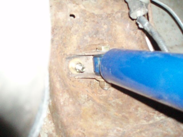

I found this on craigslist; 2" AAL and coils.
I need lift with my new tires, especially since my rears leafs are sagging. I am planning on removing my rear sway bar. Can I use my brackets and make BPE's and use my stock shocks on the rear? Also, If i put the 2" coils up front, how would i measure for the proper shock for the front? Thanks appreciate all the help.
:thewave:
· Yup, just me.
2,489 Posts
The sway brackets work OK but they will bind a touch as the are oriented wrong. I believe you will need to buy sleeves for the factory style shocks though, I know I have seen them at NAPA and the hardware store will have some too. I am thinking the YJ front shocks are about 2" longer...Just looked it up and they just shy of 2" longer so they should work just dandy. :)
· Super Moderator
13,575 Posts
Discussion Starter · #20 ·
when you say work "OK". what do you recommend instead?
Are you suggesting I purchase yj shocks for the front?
