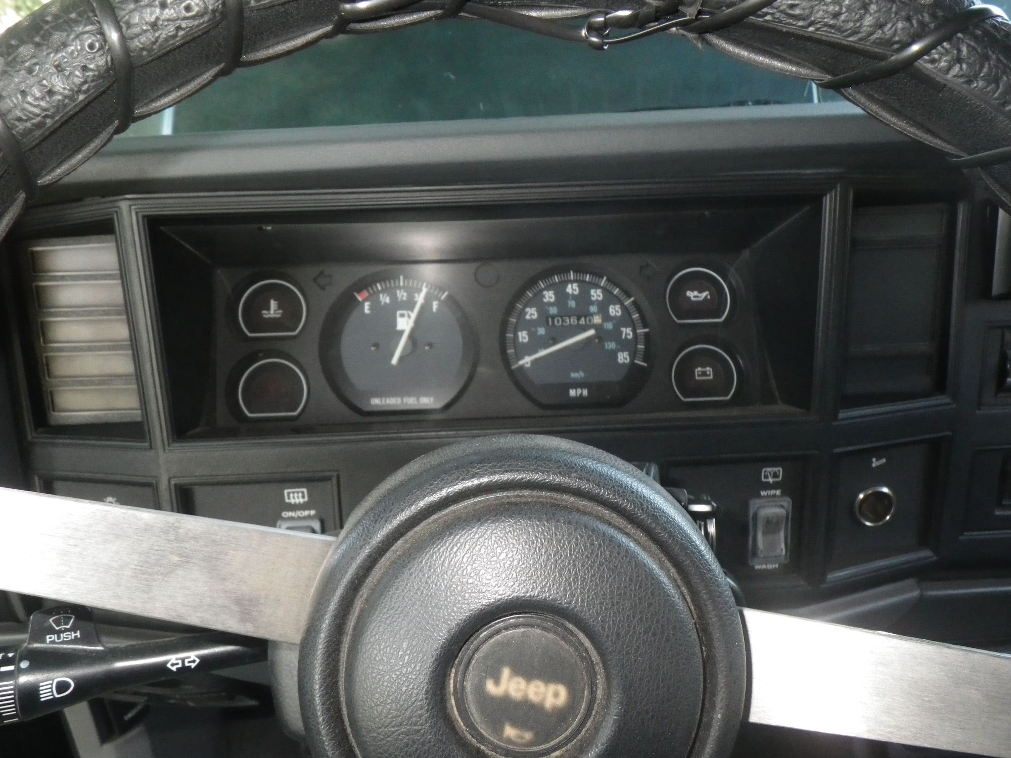

ever since I got this XJ I wanted to put a better dash in

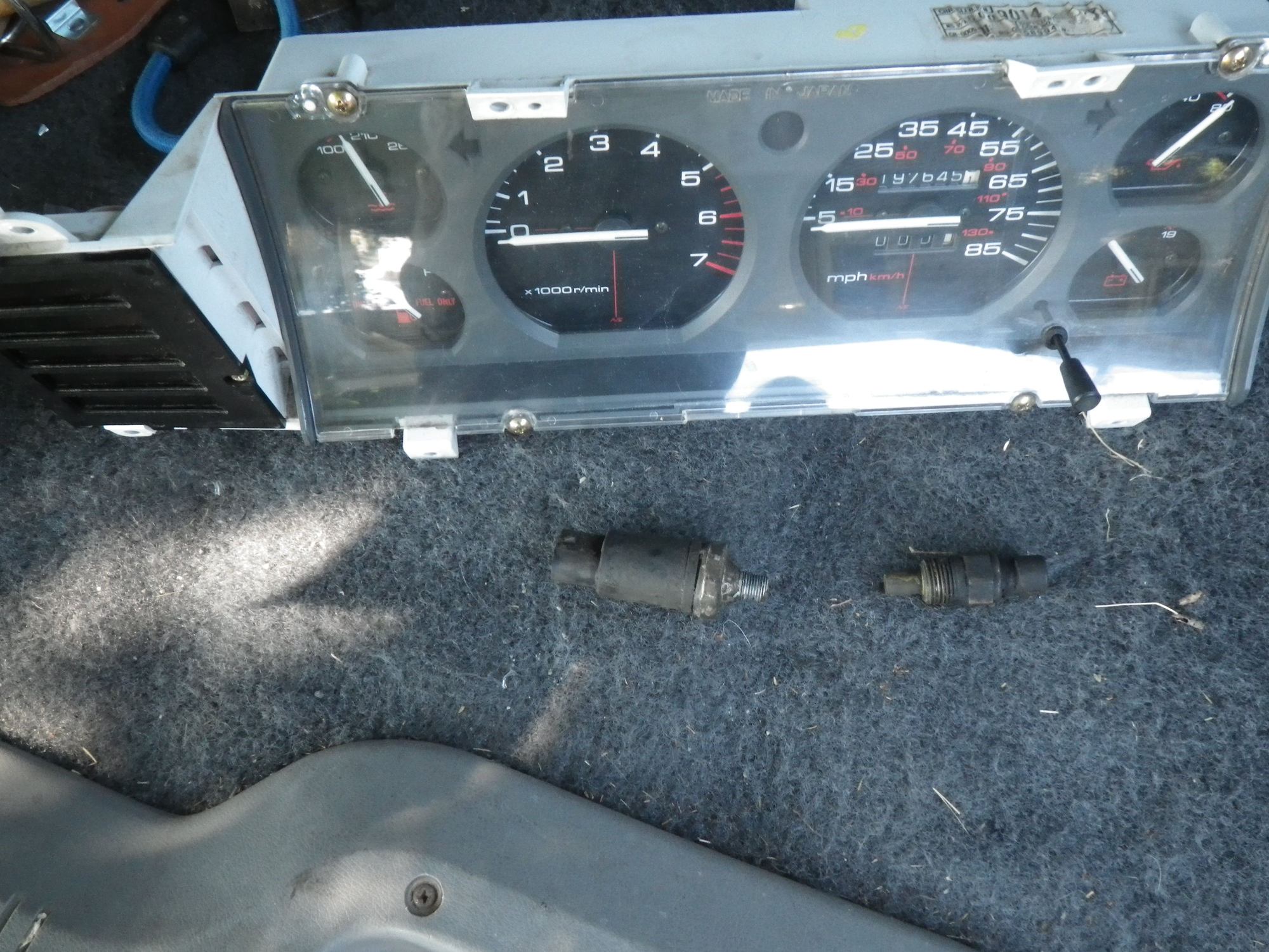

I upgraded to a 93 lardo gauge cluster
added
tach
H2O temp
volts
and Odometer

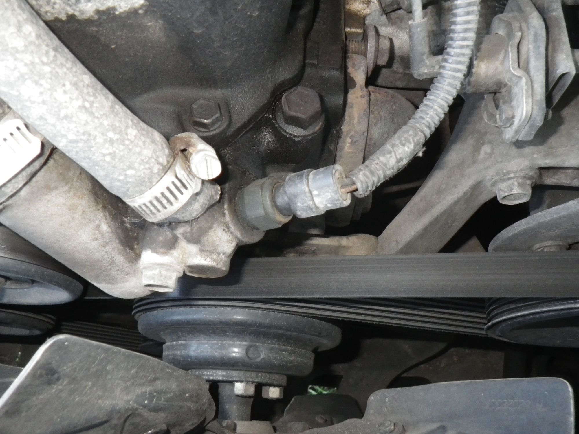

Quick top relive the pressure before you take the H2O sender out
( yep I got sprayed with hot coolant :( Doh)
before
temp sender
oil sender
the parts you need
after
this is not the temp sensor I needed for the gauges so I will pick up the right one at the J yard
it is on the head toward the back on the drivers side

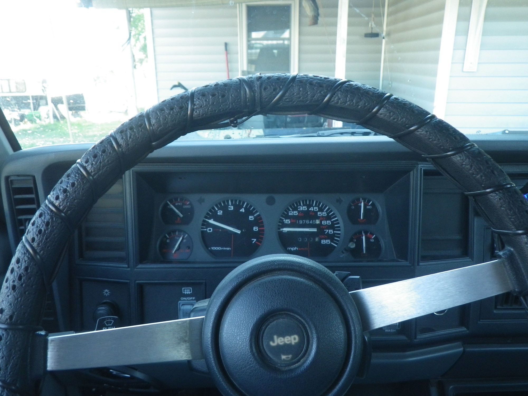

I got the right sender unit for my temp gauge :thumbsup:
went to install ...oops this one has a spark plug top and mine has a plug :thumbdown:
so take a deep breath cut the wire and crimp on a connector find two nuts that fit the top and viola temp gauge works
now I have a fully functioning gauge cluster :cool:
glad it didn't workout the other way because I would had to found the plug in good shape :brickwall:
