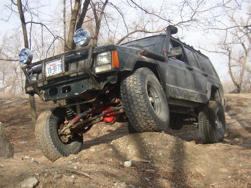

This is what im working with. I bought the jeep already lifted and tires.
I have since installed the snorkle, a new 4.0, fender flares, cb, roof rack, and a rustys steering brace. Not sure on the lift 4.5"-5.5" or brand. Tires are 33x13.5x15. Would like to keep tires and rims for an extra set.
I get to spend around $1,000 just on my jeep. This is where I need your guys help. It does not go very far but i need to stretch it as far as possible.
