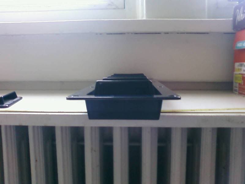

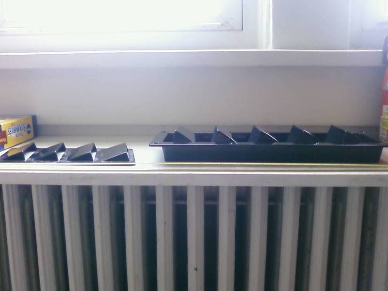

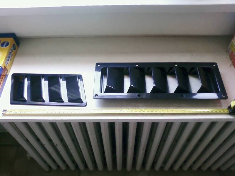

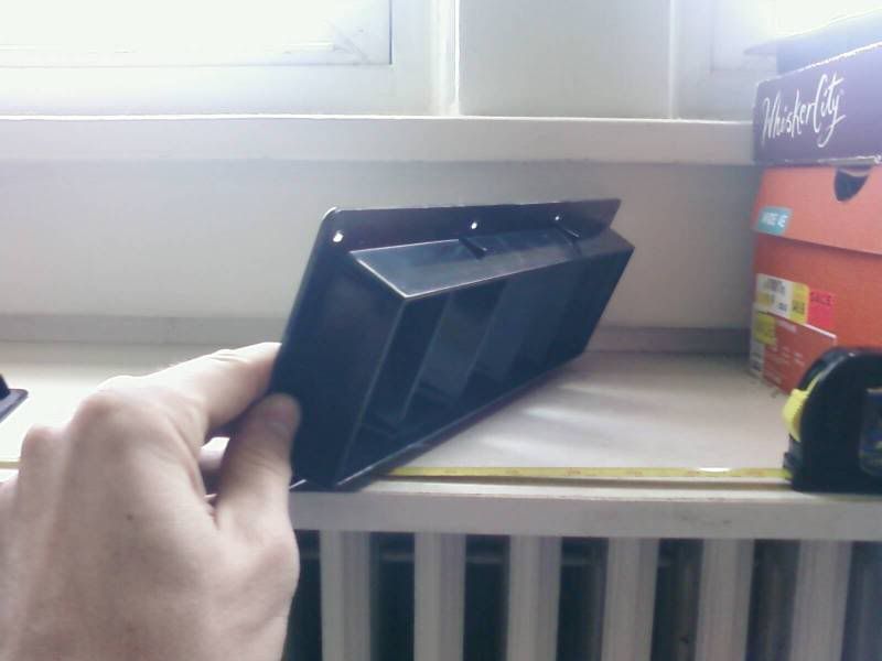

This is a write-up on installing hood vents on your xj.
These are the vents i chose:
