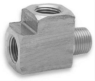

Very cool - many thanks, Ralph - I guess, this is exactly the installation I am looking for as you can use the mechanical gauge as an option or hooked up permanently. Any part numbers are very much appreciated - thanks! Also: I would like to use a braided stainless steel hose instead of the nylon tube.
Sorry for the delay. The "T" is Edelmann 227200.
Now for some reason I can not find it on the O'Reily site for but here:
Also I can't confirm this to true but looks like the Edelmann part crosses to the Weatherhead brand part number 3750X2.

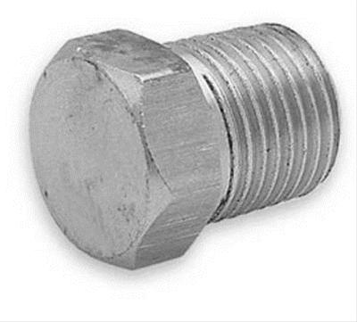

The cap which I am guessing you won't need is Edelmann 209200. Which I also can't seem to find on the O'Reily site.
Which appears to cross to Weatherhead 3152X2
