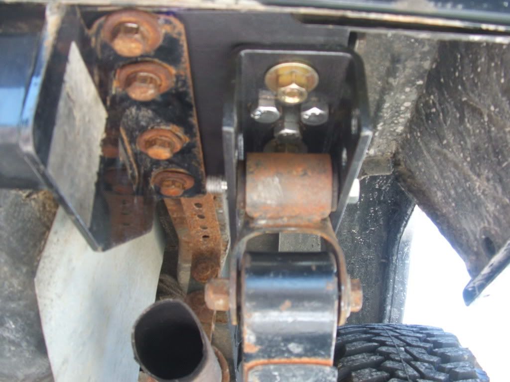

I didn't like my shackle angles from the RC springs (vertical) so I slapped in some HD Offroadengineering shackle relocation brackets:
Much better angle and improved ride:
