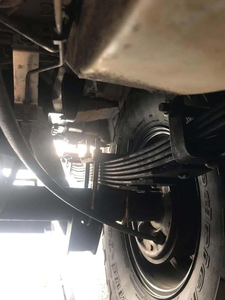

Hey team,
I just noticed this while the Jeep was on the lift getting exhaust work done. My new leafs seem to be arching over the axle to form a “W/ Mustache” shape, as opposed to a “U” shape. (This is a drive-on lift at the shop, as opposed to a frame lift, so it sits as it would on the road).
It’s IRO 3.5” packs, IRO 1.5” Boomerang shackle, Iron Man Shackle Relocation Brackets.
I reached out to IRO and they think it’s caused by the relocation brackets and recommended removing them. :(
Only thing I realized during installation is I installed pack onto axle first, then lined up front and rear bushings. Would installing ends first, and then securing to axle be any better?
Here are some photos.
Thanks!
Sent from my iPhone using Tapatalk

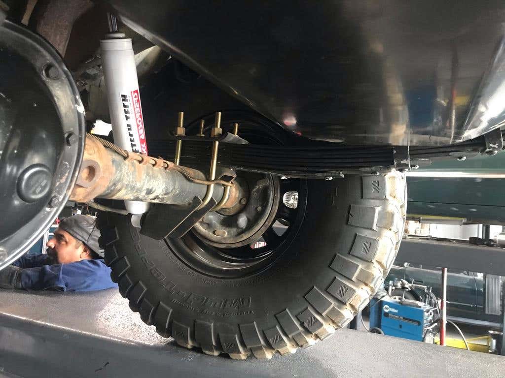

I experimented with moving the shackles back one hole on the shackle relocation brackets. Not much, if any, difference in the springs or the ride.
Took some photos while leafs were at full droop and shackle bolts loose. Sorry for the dark lighting; had to start working on it at 4:30am to beat the triple digit heat outside!
And here is how it looks with vehicle weight on them, in the new position on the SRB.
I’m really torn about putting any money into these. I want a solid rig, but I also am happy with the ride and height. So if it’s not going to get worse or cause issues, I think I’d roll with it. I dunno. lol

Hey, I just found this post and am currently with mostly the same problem, except it’s just their boomerang, and 3.5 leafs. Mine look exactly the same, only a couple hundred miles on them, and leaning about an inch passenger side low. Was wondering what came about with your leafs?

OK, now for my 2 cents. First I will tell you that I used to design and build lift kits from scratch in the 70s, until Rancho put me out of business with Chinese stuff. I have also worked briefly in a spring foundry. So here it is.
I see two things wrong here. First the middle of the spring is not supported enough and all the bending is there. Eventually, this spring will sag as it will loose the temper there from being bent too far.
Second, I am going to trash some internet conventional wisdom. It is a popular thing to put the shackle at the angle you have there, and you obviously bought a kit for that purpose. However the reason they soften the ride is that they make the spring bend exactly as you have shown here (Thanks for the pics on this). The spring bends in an unnatural way and only bends on one spot instead of all over so the ride is "softened". Now I can find probably a hundred guys on forums that will disagree with me on this, but the proof is in the pics.
You nailed it. Put the shackles back to the proper position where they we're originally engineered ( not the guys who built yours) to go IE Straight up and down and you'll get the springs back to the correct curve. Yes you will lose the smooth ride a bit but the springs will last a whole lot longer.
