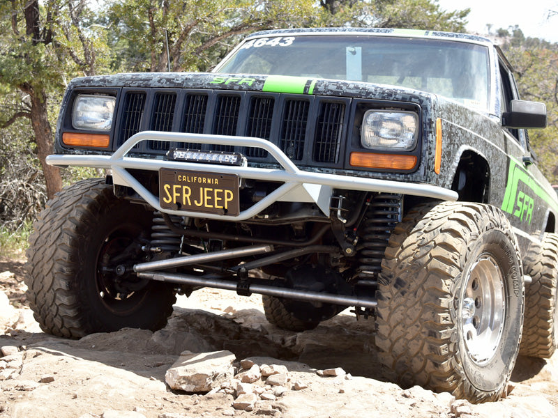

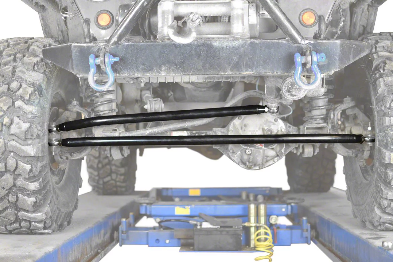

A few posts back in this thread 4.3Lxj linked a RE (Rubicon Express) steering kit in a post. Check that one out. I have BLees (no longer in business) and its been good to me. Its exactly the same as the Steinjager kit. My main reason for that choice was because I absolutely hate tie rod ends. Personal preference. But for most people TREs are less maintenance and will be fine. The atached pic might help you decipher what parts we are talking about.
