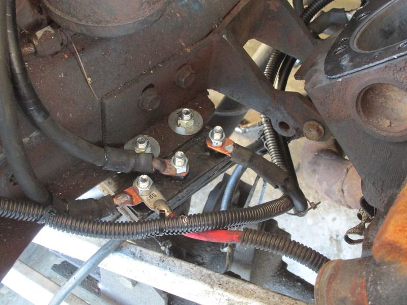

Since I had my Jeep torn about halfway down to correct a bunch of little stuff and some blown head gaskets, I redid my battery cables and ran them through the passenger compartment from the batteries in back and through the firewall by the AC drain and ran then to this homegrown buss bar. There is still one more cable from the winch to attach to it, but it beats connecting them together and wrapping it with weather head tape. Hopefully if I get a red hot cat and muffler again, I won't have any more silly problems with welding my undercarriage.
The red cable is from my 250 amp alternator which will be connected directly to the winch stud on the buss bar. Should have plenty of juice for that power hungry Warn

Veddy Nice!
