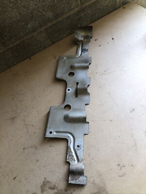

Something else I have always wondered about.
From my days of stalking for XJ parts, don't really do that much anymore, I came across this.
I always wondered about it.
If it would fit other years, exactly where is it positioned, would it be better then the regular heat shield my '00 runs, etc.
Until a couple days ago never really thought about it or researched it.
Might take a dive into it seeing my current situation.
