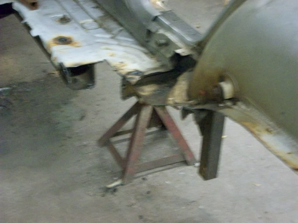

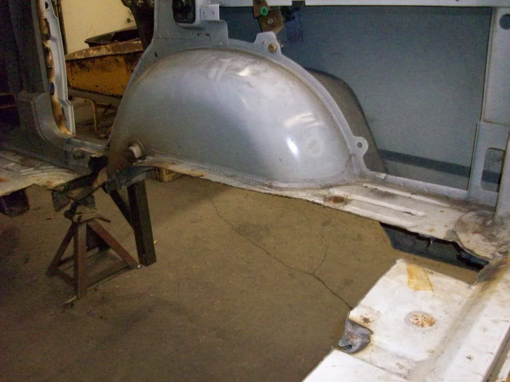

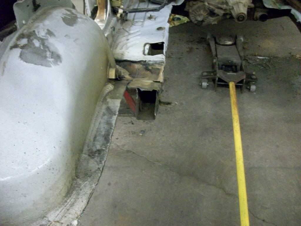

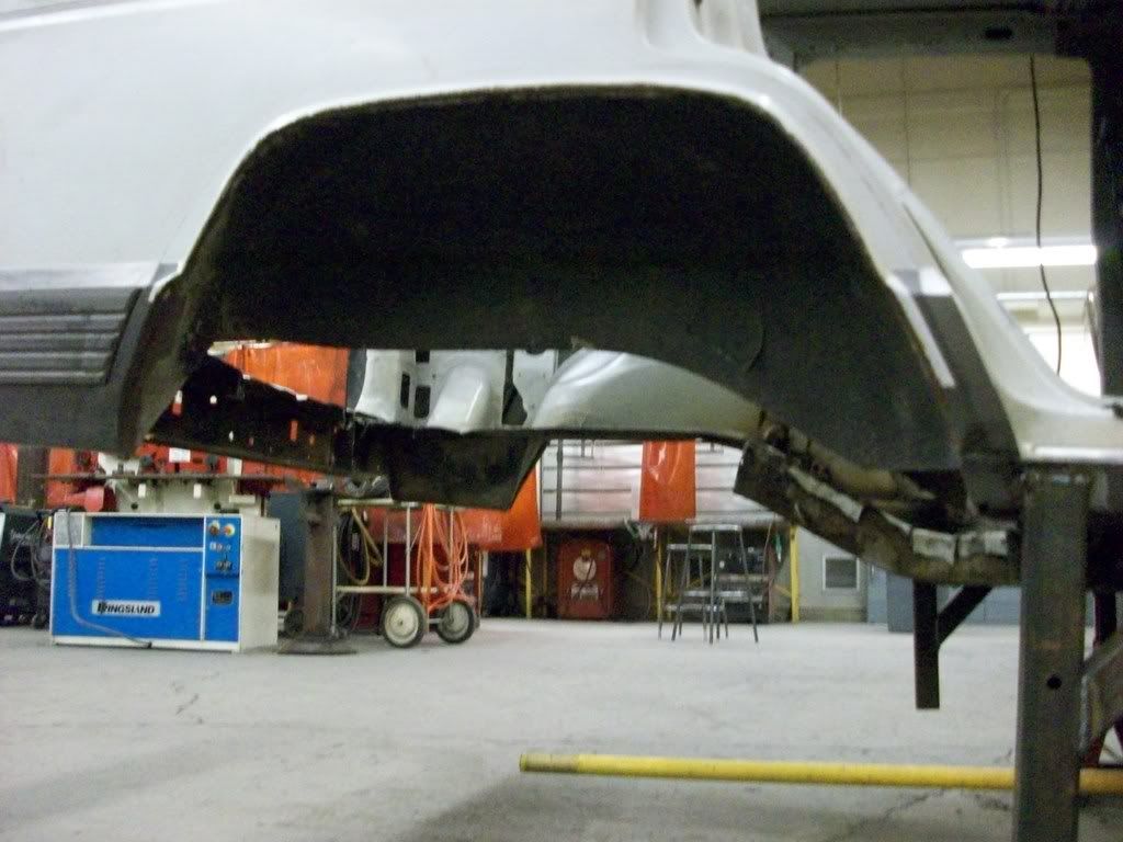

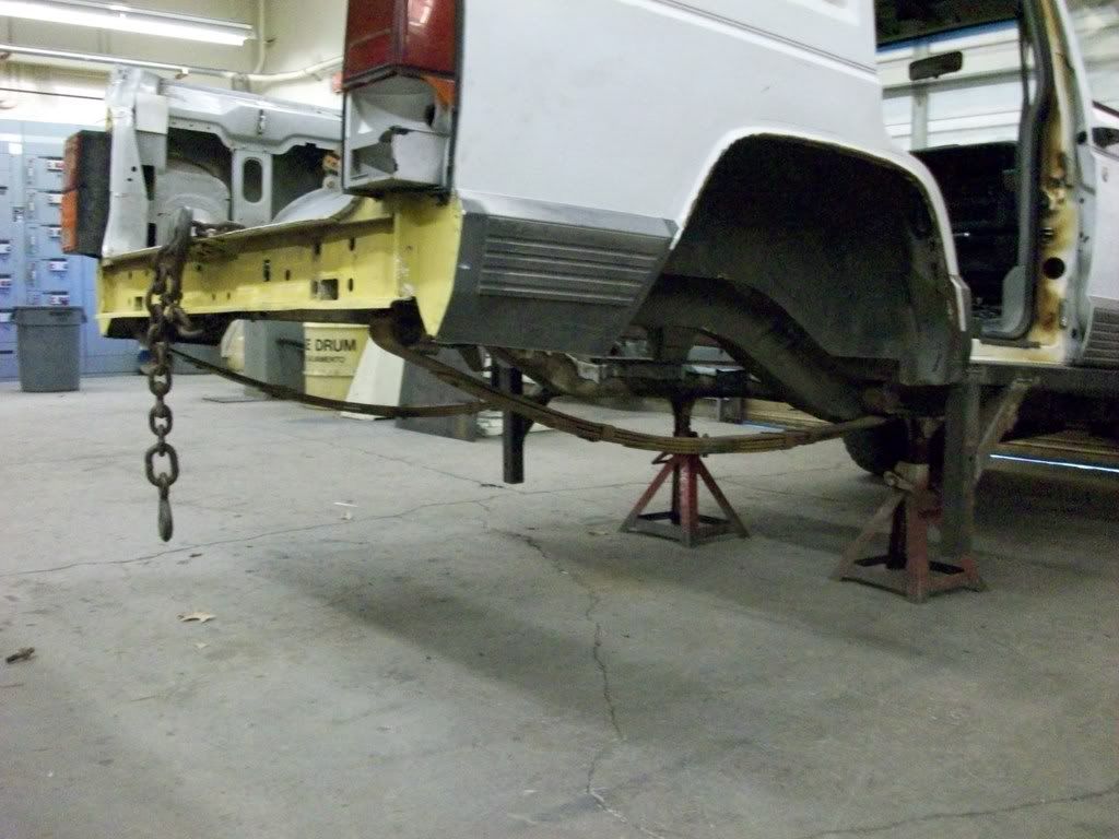

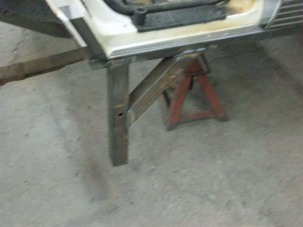

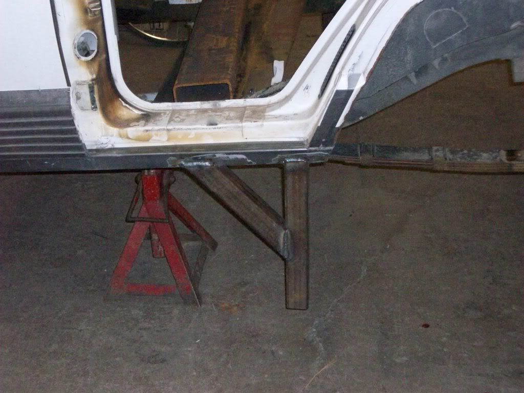

=) Thanks guys!! well got a little more done in my afternoon fab class.. got the rear end cut out and the stands ill be using to wheel it around on all made and welded on there.. the casters on yet in these pictures but just imagine them there lol..
Here we are.. 1pm - 4pm Day 1
STARTED THE DAY OFF RIGHT BY DRAWIN' A LIL BLOOD, LOL
DRIVER SIDE TEMPORARY CASTER MOUNT.. DONT GIVE ANY CRAP ABOUT THE WELDS LOL I WAS STICKIN 1/8' TO RUSTED OUT 18G
AXEL IS OUT =)
AND THE PASSENGER SIDE CASTER MOUNT..

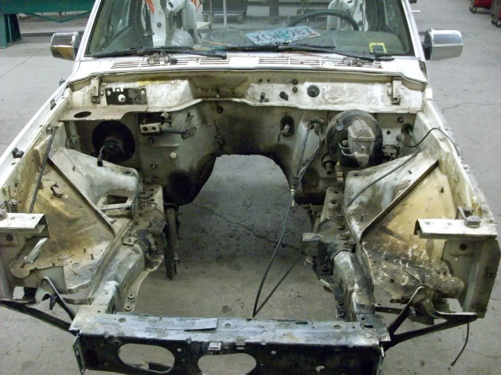

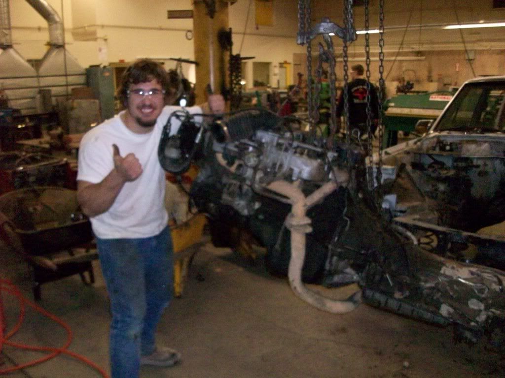

Now for TODAY!!!!! Very very productive day it was... Now today being the day that i do not have welding all day long, i was interrupted by my other regular boring classes and football.. but i got in there from like 10-12, 2-3, and 6-9 and managed to get the motor, tranny, and t-case completely pulled, the front end taken out, and the engine compartment pretty well stripped and prepped for the plasma torch tomorrow morning.. =)
Heres some pictures..

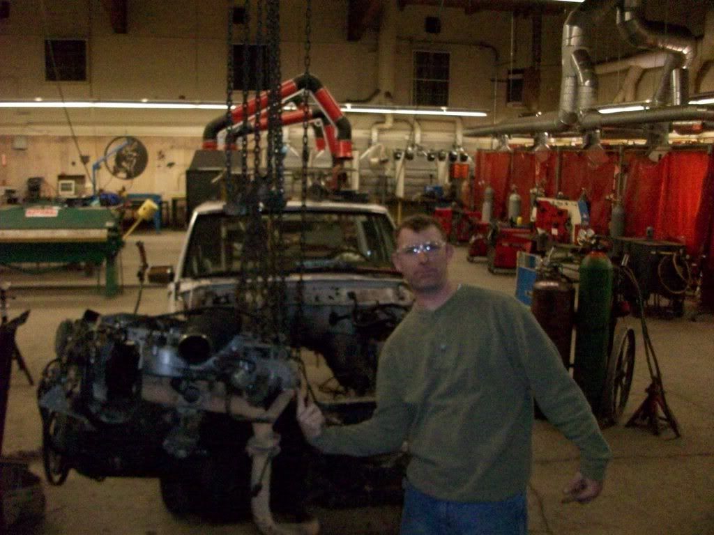

Buddy Mike, helped me finness that long drink of water outa that hole.. and welding instructor James to follow..

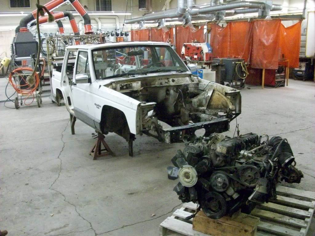

the two piece version of the XJ =)

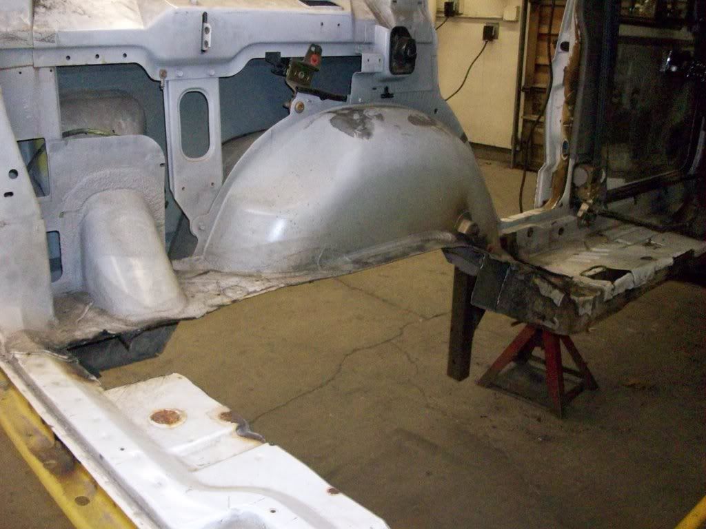

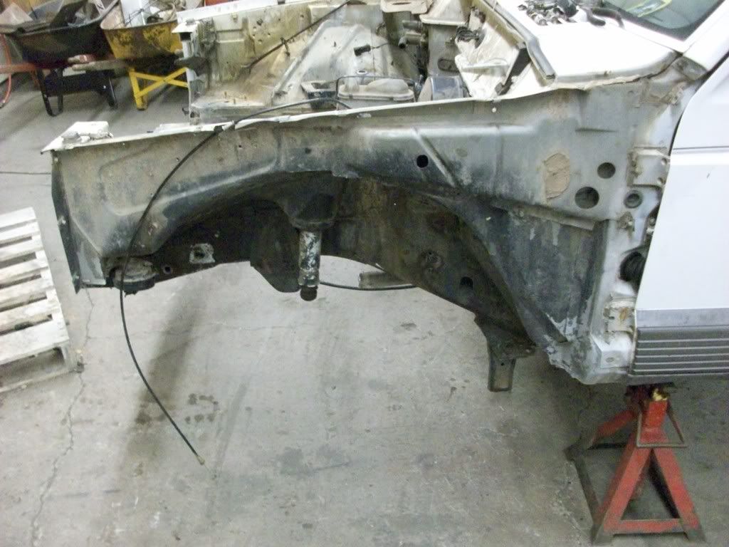

Engine Compartment..
Driver side... THAT WONT BE THERE TOMORROW!!!!!!!!!

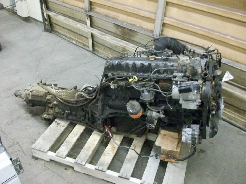

last but not least... The heart of most every XJ.. who wants to buy it haha
