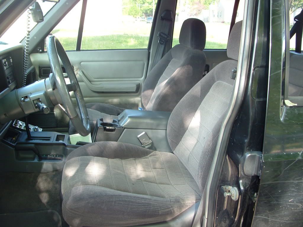

I have zj seats in my 93 xj there is a little mod to do but its not bad. i havent done the backseat yet but from the test fitting that i have tried you will have to cut some of the plastic seat bottom off of the outside rear corners of the bottom seats

I will try to get a writeup together here is a pic of the installed front seats
A writeup will be very helpful, thanks.

I used a good stout peice of angle iron on the front to mount from the original mount to the new seat and on the back mounts you have to drill new holes and bolt throught the body be sure to use big fender washers. I will try to get some pics taken this weekend and post them up
