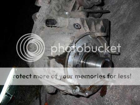

To find a donor, you can either go buy a new one, or a used one from the wreckers. If you doing the NP242, you can find it in more commonly in the 1980's Cherokee, or less common in 1993 Grand Cherokee, as it was only sold as an option. The easiest way of telling if the vehicle has one, is by looking at the shifter bezel. If you see all 5 settings, your good, but if you can’t see the bezel, you will have to get under the Jeep and look for the ID tag on the TC.(see Image1 below)

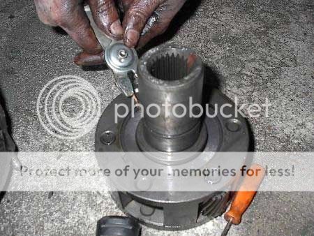

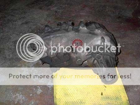

-Remove cover on the tail shaft. (See image 2 & 3)

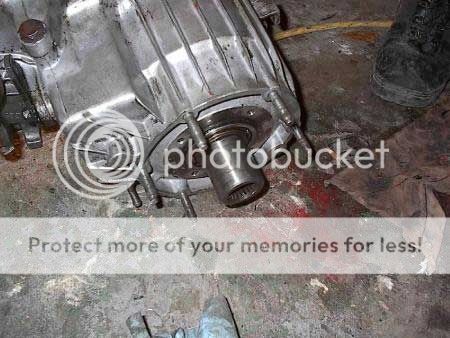

-Take out the bolts in the center of the case and break it open. (See image 4 for open case)
